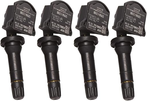

K, so here's the skinny over here. The 52933-C1100 units that I had purchased and installed earlier in the year could not be read at any location I tried. I had them put in at our Costco. Fortunately, I also had a set of 52940-L1100's (notably, mfr'd in Korea) that I had purchased as well, owing to the ambiguities I had read up about. I just, this weekend past, had the Costco swap them out (at my cost). After about 10 minutes of >50Kmh, the swapped out 52940-L1100's were picked up, reading accurately, and we were away to the races.
So, mayhaps it was a mfr problem, I don't know, but these(52940-L1100 units) are what I popped into the snows:
They currently appear to be out of stock (go figger), but these are the ones that worked for me.
Cheers!
